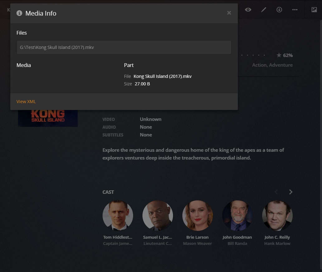

Wanted to follow up since it didn’t work for me. I ended up downloading notepad++ and after opening it, I typed in, for example, Kong Skull Island (2017), then saved it. Then when to where I saved it, right clicked it and selected Rename and added .mkv at the end. After adding a folder and putting the file in there, I added the folder to Plex and scanned it but came back with no results.
Thanks again for any pointers on getting this working!
And Kong Skull Island (2017) was not only the text inside the file but also its file name?
Kong Skull Island (2017).mkv
I got an instant match:
Try with the attached file (unzip first)
That might be the problem since inside the file I only had Kong Skull Island (2017) and left off the .mkv. Will try it again this afternoon and let you know if it works. Thanks again
No, the .mkv is only suposed to be in the name of the file, not inside it.
