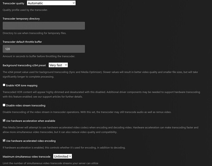

Here are my settings:

This behaviour is completely normal.
It transcodes 60 seconds of buffer and then does small chunks to keep up with the buffer.
