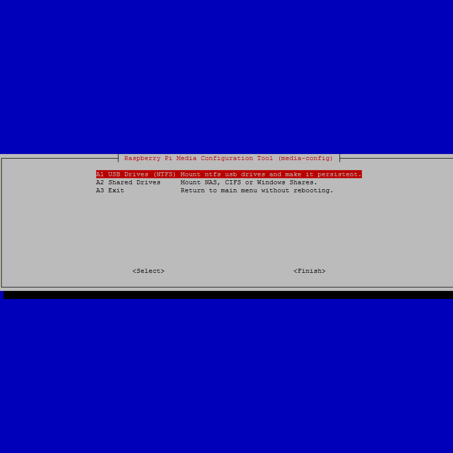

Free advanced menu to setup Raspberry Pi 3.

Media configuration sub menu options are listed below.
•USB Drives (NTFS) - Mount ntfs usb drives and make it persistent.
•Shared Drives - Mount NAS, CIFS or Windows shares
•Exit - Return to main menu without rebooting.
The media menu configuration options easily configure the Plex Media Server USB (two drives) or Share connected media. Simply plug in your USB drives and or complete the previous network connection configuration section so that you can reach network shares of NAS devices then select the option required and answer basic configuration questions. After simple menu driven configuration a quick reboot provides the mounted drives for access.
Video: Demonstration of free advanced configuration menu
Site link here: http://www.iiot.co.za/Solution_Raspberry_Pi_Advanced_Configuration_Menu
