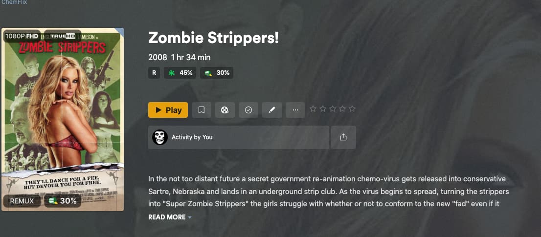

After the conversation we had before I decided to run plex meta manager PMM with the operation mass_user_rating_update: reset which effectively removes the stars (user ratings) on the preplay of an item. Before I ran this, the stars on preplay were according to the ones on the activity tab. Problem right now, after removing the user ratings with PMM is that the activity tab still shows my user auto-rating. Something that a) I never rated and b) I never watched. See screenshots for more clarification and THANKS SO MUCH
As you can see in the screenshots, that is an unwatched movie without stars on the preplay screen (because I just ran PMM and removed them) but the activity tab still shows the old rating that I never rated. All that activity in my entire library is around that time Oct 11th.

My initial question was around whether the activity ratings matched the preplay ratings. If they didn’t I’d have been quite surprised, because there is no way to generate activity ratings (which are stored in the cloud) without actually, well, rating the content (which would show on the item preplay). It sounds to me like they did, since you needed to clear them out.
I’m guessing PMM has a bug where it adds ratings to everything in your library, which is… very unfortunate!
I can go into our cloud DB and delete the “activity” ratings for you, I’ll let you know when it’s done.
In the meantime, can I also convince you to try to reproduce the issue with PMM? It’d be super helpful to understand how in the world this could happen, and then report it back to PMM…
