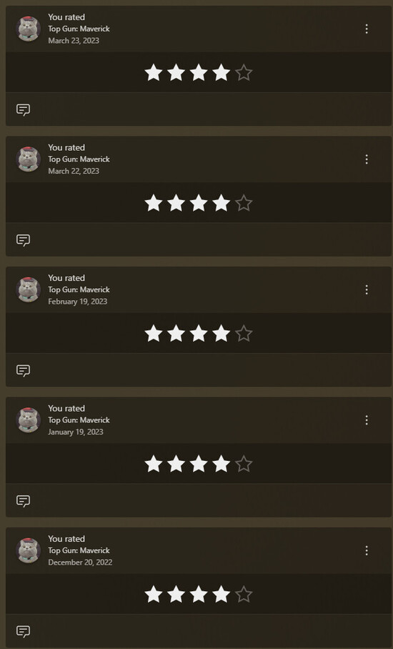

I’d also like to request that ALL user ratings be removed. I don’t use the feature and there are just too many to do it manually. Some items have 10-12 ratings per item.
I also noticed this shortly after configuring PMM and messing around with the user ratings overlay.I haven’t tried to reproduce, but I could probably share the configuration I used right before this happened. I’m almost certain the two are related even through their folks claimed it wasn’t possible.

Not knowing exactly what I was doing, I applied Rotten Tomatoes scores to my user ratings. Also, at the time, I was having issues getting the script to complete, so I was starting it over and over to diagnose where the issue was. It ended up being an issue with using Mdblist as a source. Once I removed that, it completed.
Anyway, the constant running of the script, and the multiple entries for certain items, combined with the timing of the issue leads me to believe with almost 100% certainty that PMM is the culprit. Unfortunately, they have no operation to remove the activity.

As for the data, we will clear all ratings activity for you two, @jpalenz and @dbowles1975 . It should be done tomorrow, I’ll ping in here when it’s done.
In the future, we will support more bulk editing actions for this data, so that hopefully you can clean this up yourself if something goes awry.

@jpalenz you’re correct! Your ratings data and @dbowles1975 data have been cleared on the backend.
