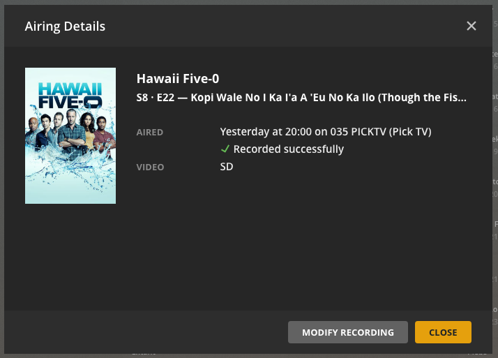

Forgot to add that Plex thinks it recorded Hawaii Five-0 successfully (despite starting 20 mins late etc etc):
