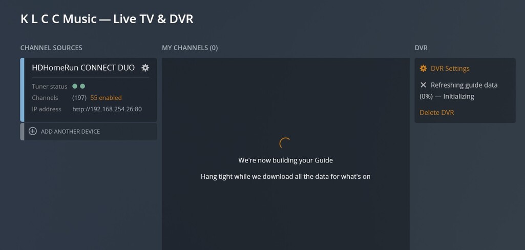

Refreshing Guide Data (0%) - Initializing and stuck there

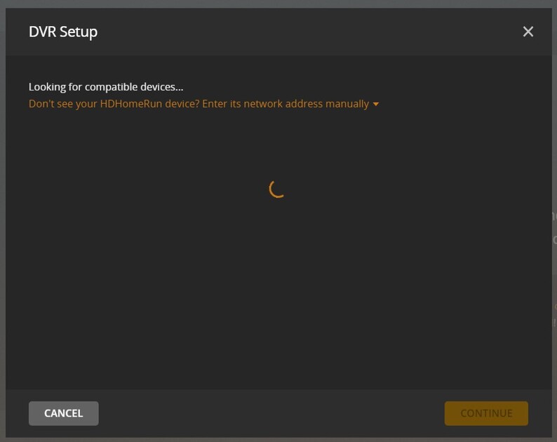

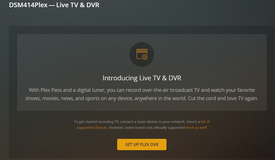

I followed the procedure per the linked instructions. This was a bit different than what I did before.
Unfortunately I am still in the same situation. There is no tuner found at least not in UI. The screen shots of what I see are exactly the same as previous message. The log does indicate that tuner was found somewhere along the line so there seems to be disconnect.
this is from the log today after restart and the same thing was in log I sent earlier.
I am trying to make sense of the errors in the log - not easy - Here are the first 5 after just a few minutes. Any help in these?

I have been having the exact same issue as original poster. its been spinning for weeks!!!
I have upgraded the PMS .bin flle multiple times since it started happening (with no changes or improvements).
I dont actually need Guide Data for that Server as I only stream my music on my WDMyCloudEX2 Ultra server. Any TV/VIdeo stuff is done on my other PMS server on my NVIDIAShield, so I even tried to remove the OTA Tuner and delete the “MOVIES” and “TV SHOWS” menu selections hoping that would work since I only want Music on that one server but that didnt help either.
Im worrried its putting a daily resourcea and HDD strain on my NAS Drives or Server if it cant update the Guide.
I have turned OFF the Plex app inside of my NAS UI setting multiple times as well and had the NAS shut down but every time I power it back up Plex shows its still spinning and no changes to get from 0% to anything else
NOTE: MY Music server is my MOST important PMS and I will NOT start over on that one as I have spent MONTHS working on ripping all my THOUSANDS of CDs and setting it all up so thats not an option to start clean

My other PMS Server on my NVIDIA SHield does NOT have this issue and I am able to watch my OTA Tuner and record TV just fine and get updated Guide Data. It is Not constantly spinning so either the issuee is with the WDMYCloudEX2 Ultra .bin file or else on the Plex side.
CPU strain seems to be normal (see images below) but there was one day when my CPU for that PMS Server was over 300%!!! dont know why
Also to note:Hitting the “Cancel Guide Update” X button doesnt seem to do anything to resolve this either.
It just spins for a while and then goes back to trying to refresh the guide
Please advise
NOTE: I am also getting an EMPTY 22 kb Server Logs zip file when I try to download them!

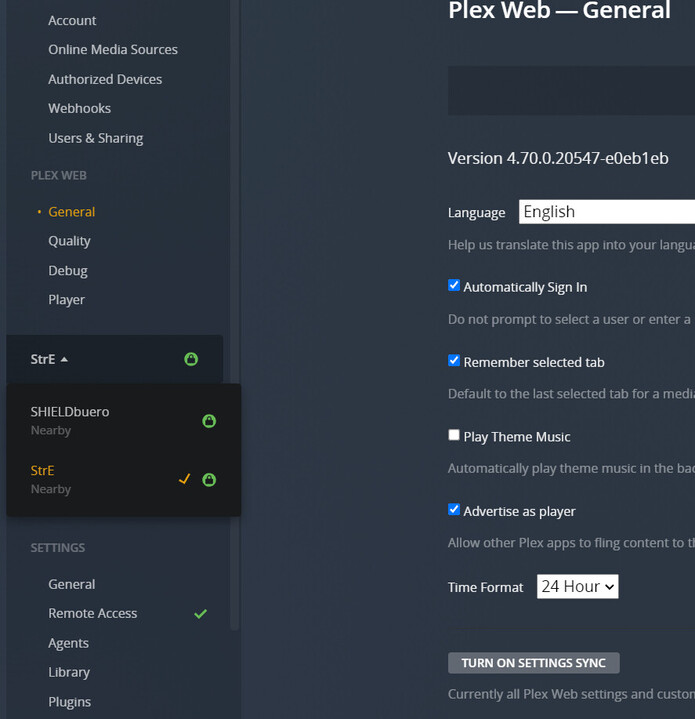

How do I make sure only 1 server is set to the DVR (which is what I want, the NVIDIA Shield server, since it CAN transcode video, and DONT want my WD MyCloudEX2 Ultra to be tied to anything video /DVR related, as I only stream my Music FLAC library from that Server) … ?
You simply don’t set up a DVR on that server.
When you enter the server settings, take a look at the left side bar.
If you have more than one server in your account, there will be a drop-down selector which you use to select the server to configure.
Make sure your NAS is selected there, then enter the “Live TV & DVR” section (near the bottom) of the side bar.
Make sure there is no tuner present in there.
You can switch servers back and forth and compare the content of the “Live TV & DVR” menu item between the servers.

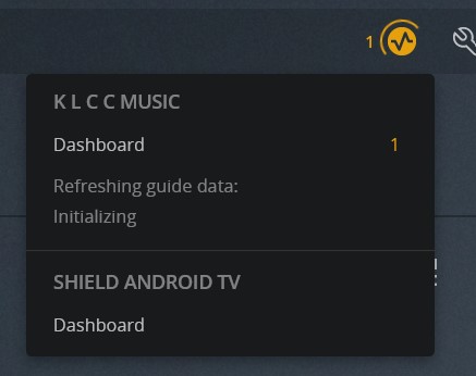

Ok its fixed
When I went to the server I noticed it wasnt spinning anymore for the Guide Update.
So something happened without my intervention behind the scenes somehow?
Anyways I went to my Music only server NAS and deleted the tuner and removed the Live TV and DVR from that server.
See attached screen caps showing the new servers and the dashboard with no spinning circle anymore
Hurray!!!
Not sure what happened bur it seemed to be finally fixed by itself after MONTHS of just spinning trying to update the guide from the wrong server
Thanks all
Dashboard fixed not spinning for guide update
After Deleting DVR
