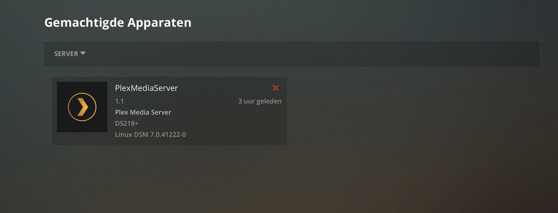

Did you also go to https://app.plex.tv → Authorized Devices → Server (dropdown) and delete the plex.tv entry ?
Even after uninstalling, Plex.tv will retain the info about the server.
I am working to see if I can effect deletion of it when you actually destroy an installation.

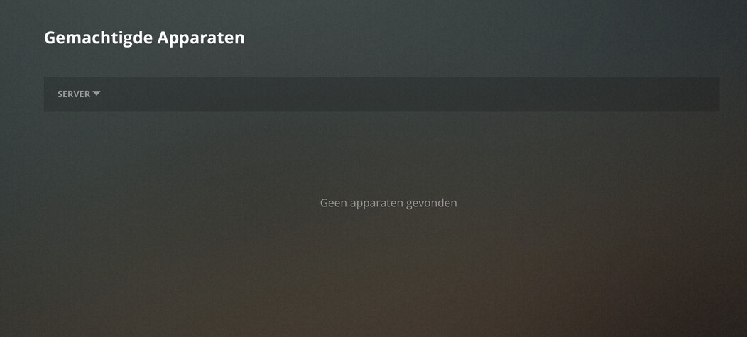

This is what I get to see. Nothing more. I have already deleted it here but it seems to be back again.

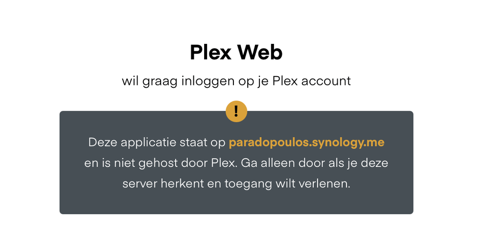

I have already taken all these steps. Now I want to reinstall Plex and start from scratch. But my Synology/Plex won’t let me. Once I have completed the new installation of Plex it just gives me the “No Soup” page and it won’t let me reconfigure the server.
So how can I fix this? On some way it’s like Plex is still thinking that there is some server on my end.

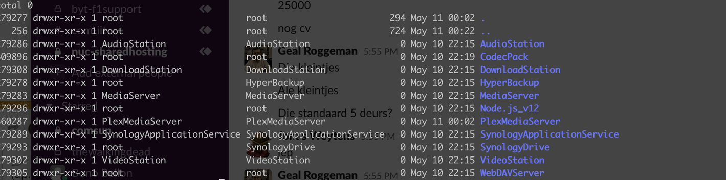

I also find these files on my server after deleting Plex.
So it looks like not every file or every thing of Plex is deleted on my server at this moment. There is something, or some reason, why Plex keeps reconnecting to the old server why this server is already gone. Any ideas?
I already did this step and this also doesn’t work. I couldn’t reclaim my existing server. So I have deleted everything and I now want to install and reconfigure the whole server. Just start from scratch with Plex. Plex won’t let me do it.
Once I have installed Plex again, I can open the application and he gives me the “no soup” or the sign that this server isn’t from Plex and that it is running on my Nas server. I don’t want this. I want to open it and reconfigure everything. That’s all I am asking for and this doesn’t seem to work.
