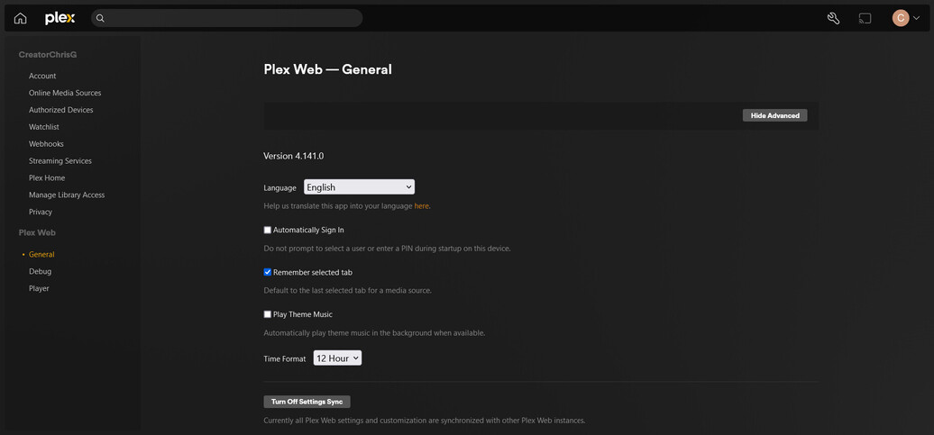

Plex somehow ceased to work on both desktop and web, claiming I had no access to my movies. After fumbling about with regedit and poking around, failing in everything attempted, I finally did a complete uninstall/reinstall and it appears to not have fixed anything.
Perhaps even made it worse.
Now I can see that my server is still up, at least the name from my attached screenshot. But I can’t access anything about it or even make new libraries. (My settings folder looks compleatly different from what other forums suggest. [see picture 2])
