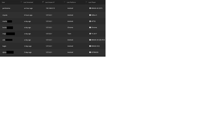

I also noticed strange behavior on Tautulli logs. For some users it shows that they are connecting on my server via same IP address and apparently some of them succeeded to connect yesterday also. Same adress, different users, different towns…
Direct remote access isn’t working but you have or had Plex relay enabled in the settings which lets people stream from your server through Plex without remote access enabled.
If you have double NAT and don’t control both routers and/or don’t have a public IP then remote access will never work in that way and you’ll have to rely on Plex relay instead.
I had plex relay enabled for long time. It was working just fine with same settings. Now its not working with or without relay, and this is first time i saw those strange IP adress in my tautulli logs. If i disable that relay its the same thing, not available…
