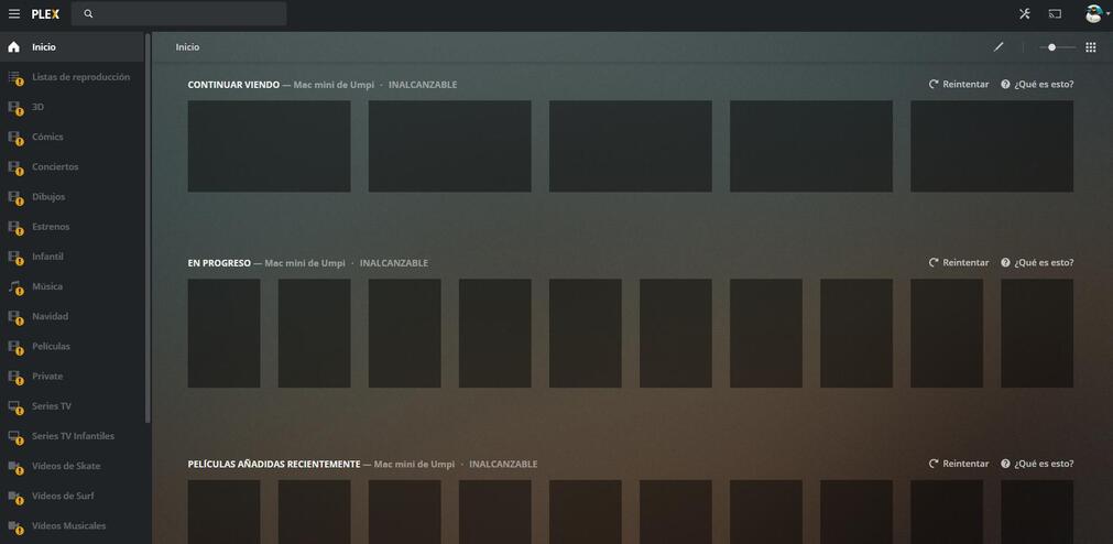

Same problem here. Since a few days I’m getting “Server unreacheable” from some devices…
I have not changed anything on my setup… same router than 4 years ago…
I have just installed PMS 1.18.7.2434 and same problem…
same problem here… everything was working until this morning. no changes, but no access with plex.tv remote or local
