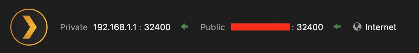

But while I have you. My server’s LAN IP is 192.168.1.44 and I think that’s what it used to say here:
But it shows 192.168.1.1
Is that what it should be showing?

This isn’t right.
What is at 192.168.1.1.
I can clearly see your NAS is 192.168.1.44
I have router going to main switch going to basement switch that goes to a mac server and the QNAP. So both Mac server and QNAP get the same wired connection. and the mac server is always on.
Trace it from the ISP please?
ISP router → Main Switch → QNAP ?
192.168.1.1 is my router. It should be sending out that IP to be available.

Yeah my Private IP used to be 192.168.1.44
So this might be the root of the whole problem.
And by root I mean, something else is doing this of course.
Does this set itself up automatically or can we manually change it?
What is in Docker with hard IP address 192.168.1.1 ??
Jun 27, 2023 21:08:43.839 [140622703344272] DEBUG - Detected primary interface: 192.168.1.1

Jun 27, 2023 21:08:43.839 [140622703344272] DEBUG -  * 2 eth0 (192.168.1.44) (24-5E-BE-5D-52-B7) (loopback: 0)
Jun 27, 2023 21:08:43.839 [140622703344272] DEBUG -  * 4 br-0f449a292e07 (172.29.4.1) (A2-35-1C-55-AE-C7) (loopback: 0)
Jun 27, 2023 21:08:43.839 [140622703344272] DEBUG -  * 5 br-108c81fac8fa (172.29.8.1) (A6-FD-3C-3A-3E-55) (loopback: 0)
Jun 27, 2023 21:08:43.839 [140622703344272] DEBUG -  * 6 br-db583f496888 (172.29.0.1) (66-D9-7A-C5-4A-C1) (loopback: 0)
Jun 27, 2023 21:08:43.839 [140622703344272] DEBUG -  * 7 docker0 (192.168.1.1) (F2-3D-E9-79-EE-5B) (loopback: 0)

In most 192.168.1.x LANs, 192.168.1.1 is the modem/router to the internet
The only docker that I created was to try and have an Uptime Kuma running. I got bored with it and never touched it again. But that docker was running on the QNAP too.
Yes that’s what 192.168.1.1 is. It’s my router’s IP
