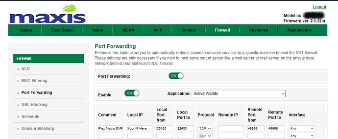

I was having the same problem. Did port forward to port 46222, open port check was successful. Brief green about 2 seconds then it went to red. Tried port forward to port 32400, open port check was successful. Brief green about 2 seconds then it went to red. Then I tried port forward to port 49999, open port check was successful. This time it stayed green. Did not go to red. It seems some ports can work better than others.
I have no idea why, but 49999 works for me too. Same issue as you (the recommended ports all went green for a second, then red). Tried so many different things thinking it must be me misunderstanding, but nope, it was simply the port.
Thank you for your suggestion, ended a few hours of frustraion with a big grin!
I’m having the same problem using Maxis Home Fibre.
Did you call them up and change your connection to a public connection?
And I assume port 49999 is the external port and 32400 is the internal port. Any help would be appreciated. Thank you very much!
I did this and it works, referring to the above comments. I dont know the reason but you can try this and share your feedback :slight_smile:
