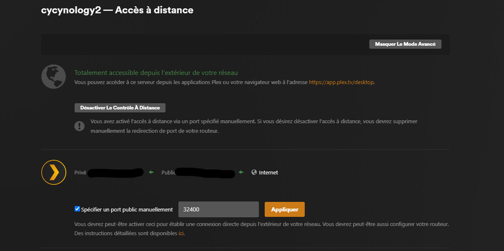

I Have exactly the same issue, I run Plex Server on a recent Synology NAS, with the Syno Firewall activated with 2 rules created and autorized for:
  • 32400 (Port Source + TCP + IP Sources rertricted to France
  • 32400 (Port Destination + TCP + IP Sources rertricted to France
I m in France, with SFR Provider and its SFR Box (UPNP activated).
When I activate Plex Remote access, it works fine (Green) then after few seconds, It fails.
then few seconds after:
I read the troubleshoots from Plex website, no hint, no help.
when I Connect In Remote from away on a TV (Plex Client installed on it), the quality is very medium and a message appears asking me that I m not in a direct access to the Plex server and I need to configure it to have the best image Quality.
Any Idea Guyz ?

Hi Tom, finally I solved my problem myself.
The origin of my problem was due to my Internet Provider (SFR), who by default propose an Internet Box with IPV6 activated and forced by default, with no possibility of Routing.
A solution was completed by my Internet Provider to activate only IPV4 for my box.
It has been done, and I cofigured the Port forwarding option that was activated then.
And I re activated the Remote Access on Plex Server.
Now all services are OK.
