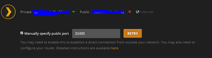

Remote Access Flashes Green after trying to connect.. Then Fails Turns Red
Hi
I am not Network Savvy enough to understand what is happening here.
Remote access WAS working for a while then, after some ISP changes it seems, remote access went away.
Talked to ISP who says nothing to cause that has changed.
Tried turning NAT on and off, Turning off UPnP and manually configuring Plex and adding port forwards. All the things I would think to look at.
One thing interesting is. The Public IP Plex says it is using does NOT match the Public IP the Router is using?
Probably something simple but over my head.
Thanks for any ideas.
John
I have a Motorola SURFboard SBG6580
Windows 10
My PMS is running in the same machine Windows 10
Everytime I try to connect I say’s connected in green then quickly turns red saying “Not available outside your network”

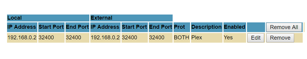

Can you leave the IP address under External blank? It should have your public IP here, not the internal, I think. I am not familiar with that particular gateway…
It doesn’t let me to leave it blank.
Nevermind, I called motorola apparently I was supposed to just type 0.0.0.0 for the external IP.
