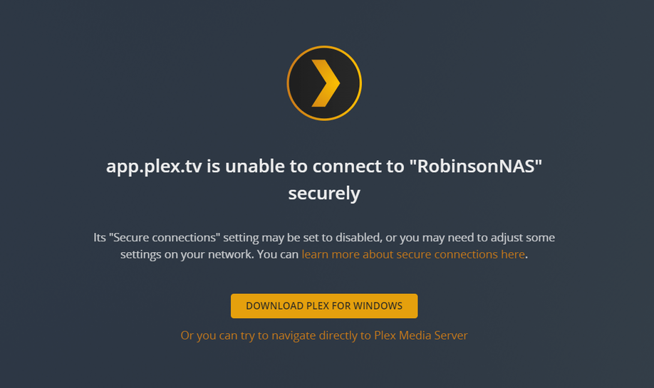

Would the inability to get a public IP address be the reason I can’t access from app.plex.tv?

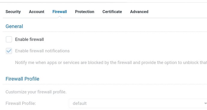

DSM 7 is a little pickier in the firewall than DSM 6. Don’t forget to either turn it OFF or manually set the ports in it. “auto-magic” auto-config doesn’t always work well.
If your modem/router UPNP works well then you’ll be ok. An ISP-provided modem/router is “Maybe”. Something upscale (e.g. pfsense) will be fine.

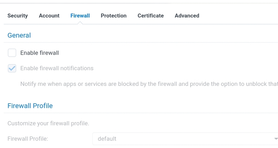

Firewall has been off and I have no idea what port I should be manually set it to. If gives me a blip of the greenlight that it’s available, then the second I try to play something, it goes Indirect. Any ideas?

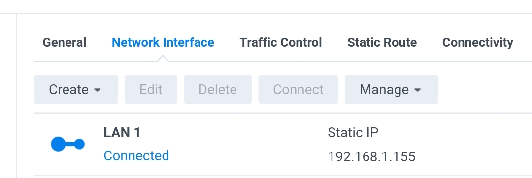

The Syno has a static IP, it’s firewall is off, and there is port forwarding enabled for TCP of my router.

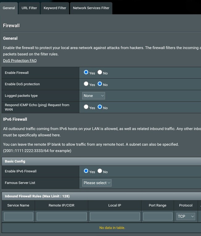

Could it be the firewall in my router preventing access?

I just tried changing the port forwarding in my router from TCP only to TCP/UDP and that’s given me the IP addresses and supposed remote access, but app.plex.tv still can’t access it.
