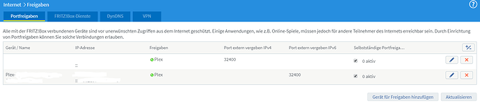

When trying to initiate remote access, I get a green connection for 5 seconds, and it then switches back to red.
On CanYouSeeMe, it doesn’t see me.
Trying to see if I have the port-forward set up correctly.

canyouseeme.org actually needs your public IP address as it cannot see/access your home network. That’s all we need it to do (see if your home network can be accessed from the outside) – if it doesn’t work, this implies the issue might be between your ISP and your router.

Can canyouseeme.org see/access the public IP address of your router at the port you’ve set as part of the port forward (e.g. TCP 32400)?

In that case you should indeed contact your ISP to ask them if they maybe block this port and if they can unblock it for you.
This solved it. Lots of German providers have “DSL-Lite” as their default service, so if you want to set up Plex’s remote access, you need to call your ISP directly and ask them to manually take it off.
