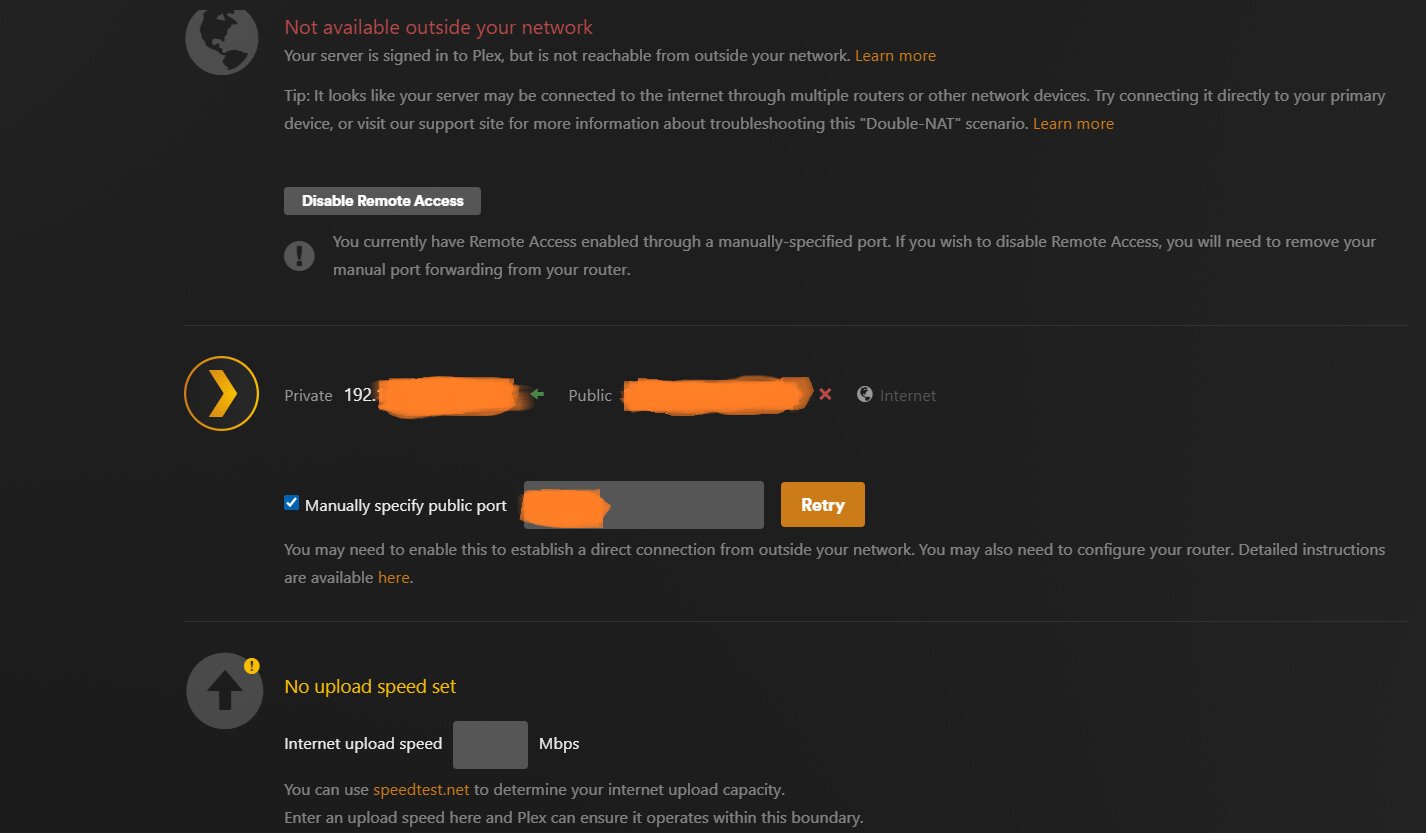

Remote access has stopped working for no reason. No changes of any kind were made (I was away when it started) and it has been working fine for years now.
I have updated the Plex server (running on WD Cloud OS5).
I have updated the Cloud Server as well.
I have checked my router as well and everything is fine, including the port forwarding which has been set up and working great for years now.
Plex seems to be suggesting a possible “Double-NAT” scenario, but this is not the case. Only one router and no other computer in the house.
Given that I purchased a lifetime pass to maintain my remote connection functionality, this is very troublesome.
