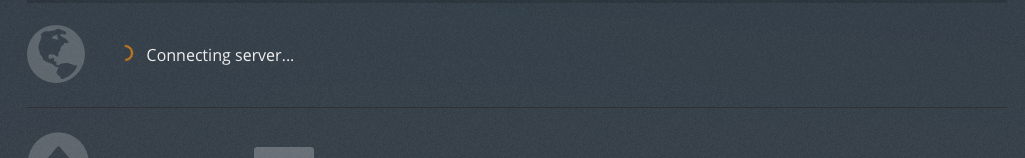

The problem is it keeps dropping out. So if I go to the Settings > Remote Access page it will show me “Not available outside your network” per screenshot:
Then if I press retry I get 'connecting to server (as you’d expect):
Then it will be connected just fine:
But, give it as little as a minute and it will drop out again.
All remotely connecting devices almost always get ‘plex server unavailable’ most of the time. If you persist the connection comes live again but it’s a right pain in the backside.
Presumably it’s a websocket that gets dropped. How would I go about fixing this?
