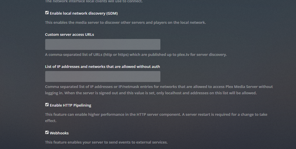

  2. The Preferred NW interface is set but I’m not sure where to add the LAN properties?

See here:
LAN%20Networks
Interestingly I don’t see that:
Am I in the wrong place?
Ben
Make sure “Show Advanced” is enabled at the top right.
I’m afraid that is showing advanced
Hmmm…
Your local network shouldn’t be set to any as if you have container station or virtual station installed those add nw switches, etc.
Fair point. I have set that to the ethernet port that I have connected.
Is that odd that I have totally different fields to you? Am I looking in the right place?
Yeah a little weird, but stranger things have been seen.
