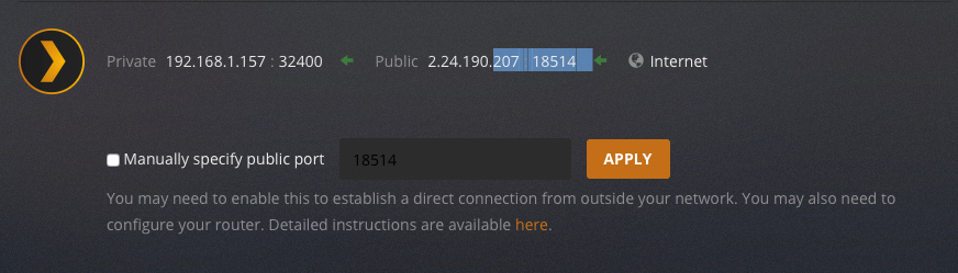

So this is my Address reservation internally:
This is my port forwarding rule

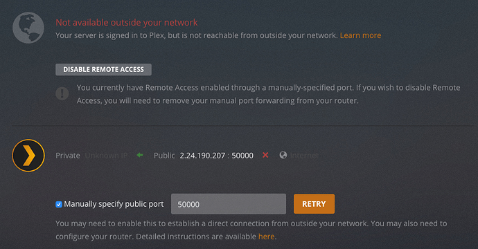

This in Plex:
If I switch remote access off and then on again it will work for like 15 minutes and then stop. The answer is near!
Is there anything I am missing?
What’s interest is if I set it to autmatic port and then use the port it’s automatically using as a static port it just breaks (I added it in port forwarding and disabled the old one:
@Salzus: feedback to your four screenshots:
  1. Protocoll Type TCP is sufficient, private port 34000 is wrong, use private Port 32400.
  2. manuelly specifiy public port to 50000, it must match the public port from screenshot2
