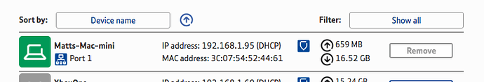

I had remote access (using port forwarding) working fine with my old BT Home Hub 5, but since upgrading to the new BT Smart Hub 6 I haven’t been able to get it working.
I’ve attached screen grabs of all the relevant ‘bits’. Can anyone help me solve this problem, what am I missing? Thanks.
FYI - The BT Smart Hub 6 supports UPnP and I have several other devices connected in this way. I thought Plex Server was UPnP, so I’m not sure why the hub can’t see this?
