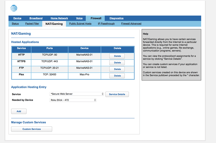

Thank you for your quick response. To answer your question, yes I had plex protocol setup as tcp&udp. When I went into my router settings to change/delete the setting and add onlu tcp, it wouldn’t let me do either. It tells me “I can’t edit/delete an application while it is being hosted”. I shut down plex on my server but it still gives me the same error. I don’t understand why everything has been working in plex for years and now I am having problems. The strange part is that people are still accessing my server even though remote access shows red in plex settings. Any help would be greatly appreciated.

The port forward in the router - is it to forward WAN/Public TCP Port 32400 to Local IP Address 192.168.1.83 TCP Port 32400?

Could you restart the router and then the server and get me a screenshot of the port forward settings in the router and open the server remote access page and confirm it is still marked as enabled and the manually specify port 32400 is still ticked and if still not working please get fresh server logs and attach with the port forward router screenshot
