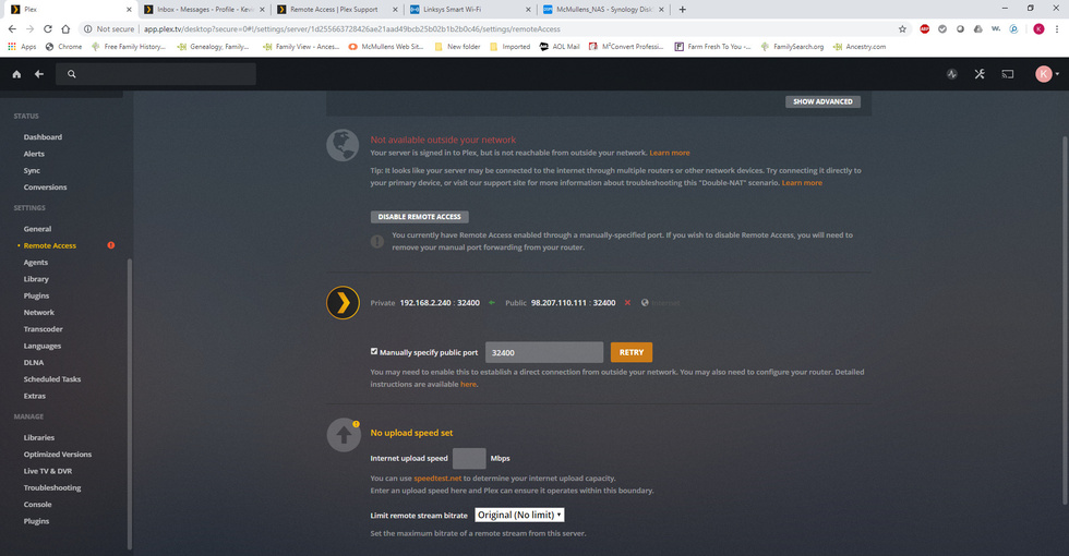

I am trying to set up remote access for my Plex Server for the first time and am getting the Not Available Outside Your Network error. I am running my Plex Server on a Synology DS916+ NAS. I’m running PMS version 1.15.4.994-107756f7e. My router is a Linksys EA6500 with UPnP enabled. I tried having the router automatically set up the port forwarding but that didn’t seem to work. I have also tried the manual forwarding by setting up a single port forwarding entry in my router but that doesn’t seem to work either. When I Disable Remote Access and then Enable Remote Access, I get the green check mark by Remote Access for just a couple of seconds and then it changes to a RED ‘x’ . Can you help me?
Here are some screen shots from my Plex configuration and my router.
I’ve worked through the Plex Remote Access troubleshooting Blog, but nothing I try seems to resolve my issue. I would appreciate any assistance you can provide.

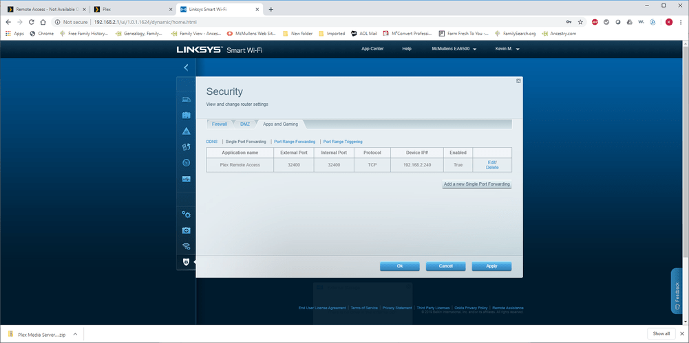

I’ve set my single IP port entry on my router to TCP only and restarted the router. Here is a screenshot of my Linksys EA6500 router.
However, the problem still exists on my Plex Remote Access. I’m still getting the Not available outside your network. (see screenshot)

I’ve done all that you’ve indicated in your message. I’ve got the IP address entry in my router with port 32400 and TCP only as the protocol. I’ve also set up the manual Forwarding in Plex as you’ve indicated. See my screenshots above. It still doesn’t work.

A friend of mine and I finally figured out what the problem was. In my firewall on my Synology DS916+ NAS I had TCP port 32400 open for any Source IP Port in the United States. Since I live in California, and am anticipating friends only from the U.S. to be accessing my Plex server, I thought this was sufficient access to my Plex Server. However, we found in the Plex log that an error was occurring, when we tried to enable Remote Access, because Plex couldn’t reach Plex.tv in IRELAND. I have no idea why my Plex Server needed to communicate with a server in Ireland, but apparently it does. When we opened port 32400 TCP for Source IP Ireland Plex Remote Access connected successfully. I’d like to understand why we needed to open this up for a server outside the United States. Can someone shed some light on this?
