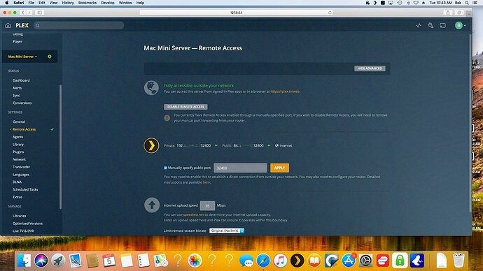

I was using the public IP address provide by my ISP (Cox) when the problems started. Changer that to a VPN provided IP address without any success.
On canyouseeme.org, I can see my VPN provided IP address on port 80, but when I try on port 32400 I can not see it. Reason: Connection refused.
This is when the remote access is working.
I am providing screen shots of the screens with remote access OK and not OK.

Well… the remote access status indicator has a history of occasionally being off. So I tend to believe canyouseeme.org if you tell us it says you don’t have access from the outside. The public IP / port not being visible implies the issue is between your ISP / router configuration…
