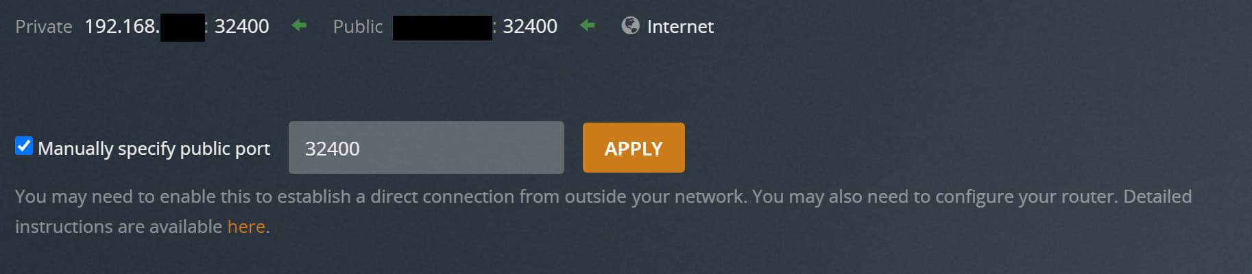

First validate your network settings in Plex via Settings > Remote Access>
Make sure you see a PRIVATE connection similar to
Private 192.168.X.XX: 32400 Public XX.X.XX.XX : 32400
Next, add a checkmark to Manually specify public port set the port to 32400 and hit apply.
Then be patient, give it 30 secs to a min (depending on your network and machine speeds)
This should re-enforce the setting in Plex and grant remote access to Plex.
Example below:
