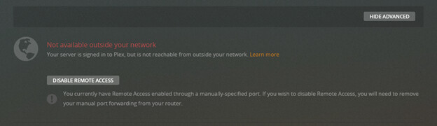

I currently have AT&T fiber, which I use their modem (bgw210-700) connected to my Nighthawk Router, (R6900P). I have gone into the Nighthawk and assigned Static IPs to most of the devices on my network via DHCP. This is including my server and the Plex Service Itself that runs on it. I found this page and have tried quite a few things from it. I manually set up Port Forwarding on my Router and Plex Server. I have also thought about the Double-NAT issue, since the modem I have to use from AT&T is also a Router. I have placed the modem in bridge mode based on the instructions found here. I know that my server is still having issues because of no 1080 off-network and I do get this under Remote Access:
If I click retry, it says it’s available until the next time I sign in and look at the settings. I am not running any “advanced” firewalls, such as pfSense, so I don’t think any IPs are being blocked. At this point, I have run out of ideas. Any thoughts?
You exposed your IP and what port you are using in your screenshot. See if you can remove the pic.

Is the server hooked up via WiFi? I know that can cause all kinds of nightmares. The reason that you are not getting any remote 1080p streams is because when the server is unavailable like that it will use Plex Relay which forces the content down to 720p 1Mbps for non Plex Pass members and 720p 2Mbps for Plex Pass holders.
Thanks for the good looks, I wasn’t paying attention. It won’t allow them to up their video quality at all. I have a feeling my server is actually not available remotely, and I don’t feel like paying for the Plex Pass as an easy fix.
I have the server connected via ethernet.
