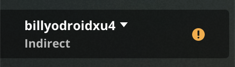

I have allowed the remote access, but it displays the message that my server is not available outside my network.
But, despite this message when I connect to my Plex account by a web browser (web client Version 4.8.1) outside my network I have access to my libraries and I can read my medias. The server access is flagged as indirect, but still displays that is not available outside my network…

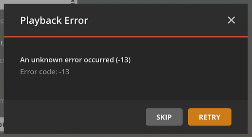

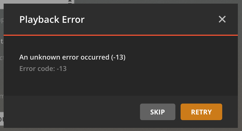

When I try to access by the Mac os application (Version 1.3.1.916-1cb2c34d), it displays an error windows (error code : - 13). The player displays my libraries but it is not able to read any content, each time I try it displays the error window.
If any one could help me to find the good settings to have the remote access working well on my different applications, and to understand why the remote status is not consistent with my real access?
