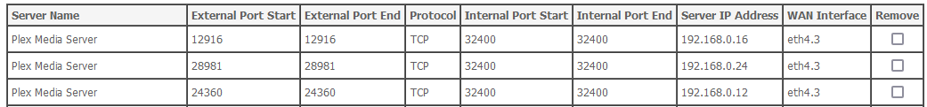

I followed all your steps :
  1. just removing the port forward rule did not bring solution
  2. so i entered the port 62535 in my router settings and in plex settings as you can see attached
It does not work. I’m a bit out of ideas!
