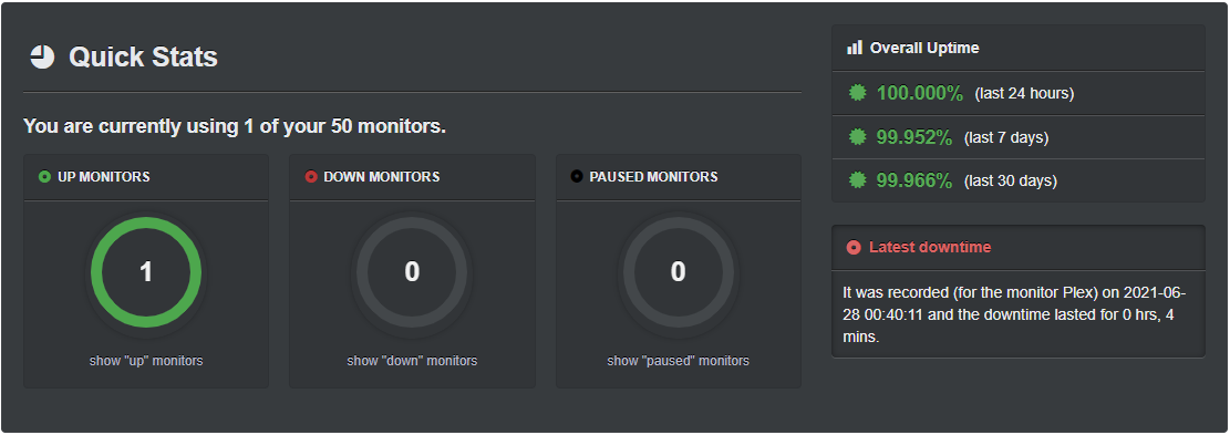

Check out uptimerobot.com.
You can configure it to monitor your Plex remote access port, and will send you an e-mail if it cannot reach your server. Default is to check it every 5 minutes. You can change the interval if desired. The free account can monitor 50 items.
Screenshot from the web page:
