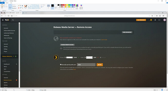

Thanks for the response. Well try as I might I could not get it to work. Of course being impatient I plugged my computer (Plex server/WD My Book) directly to my Viasat modem. I manually pointed port forwarding in plex advanced settings to the modem port of 8080. Bam, remote access,BUTTT for only about 4-5 seconds and then it says to remote access. Any thoughts
  1. If you tell Plex to look for the outside communication from that port… did you also setup a port forward in your modem, pointing all the traffic to the modem’s public IP at port tcp/8080 to the Plex Media Server’s machine (pointing at port tcp/32400)?
  2. If the above is right… have you checked if the remote access is working or did you solely rely on the status indicator?
I tried from me cell phone and it can not connect to the plex server.
It seems to connect for 3-5 seconds then shows no remote access.
Looks like something about your network setup is giving Plex the hiccups.
Are you running your Plex Media Server in your home network? At least the part we can see looks more like an actual public IP address…
If you are using LTE as your WAN connection, it might simply not be possible to use a port-forwarding.
No port-forwarding: no remote access in Plex.
These kinds of ‘mobile’ internet connections are not a fully-featured internet connection IMO, because they usually put their customers behind a https://en.wikipedia.org/wiki/Carrier-grade_NAT
