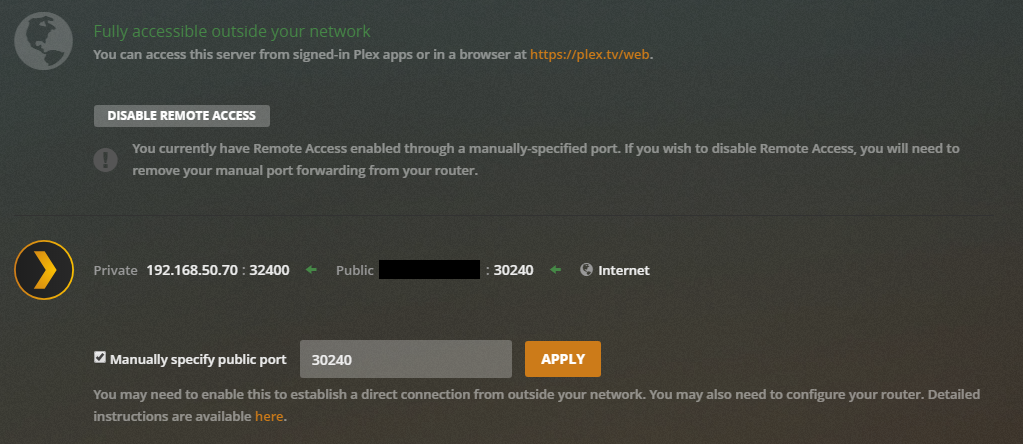

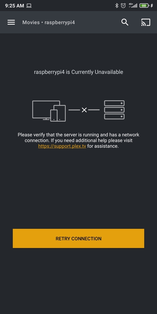

I’ve been running my plex server on my RasPi4 docker image for a couple months without any issues, but recently the remote access hasn’t been working correctly; it will refuse connections from outside my network and I have to restart the whole system in order for it to work again, and it only works for 4 or 5 hours, however the status in Settings -> Remote Access always marks Fully Accessible.
I do have port forwarding in my modem and UPnP on a separate router, but after playing with the settings I couldn’t find the solution. Any ideas?

At some point during the night the remote access stopped working. I am sure that it worked for at least one hour last night.

what’s more, last night (when it was working) the remote access status was “not available outside your network”; now that I cannot access it shows “Fully Accessible”
