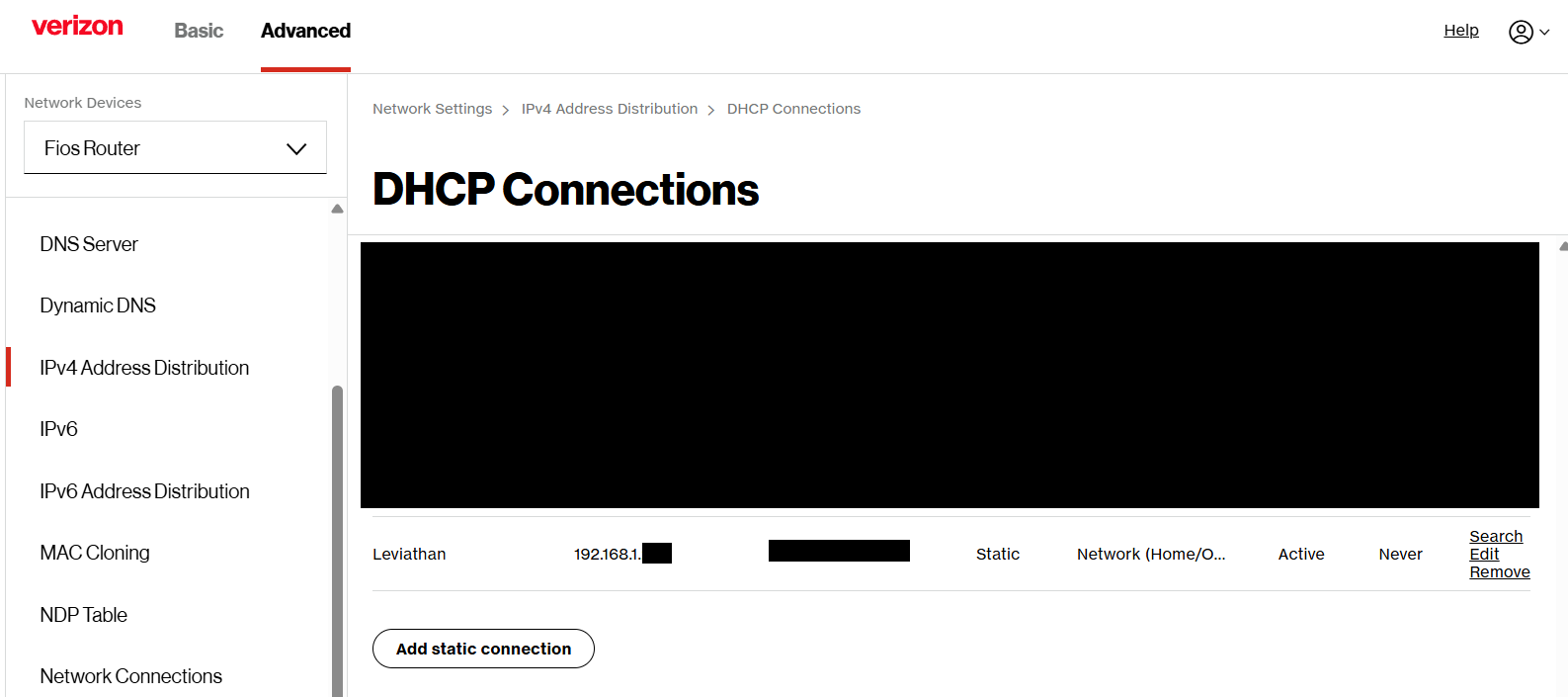

I have a Verizon GS3100 router. The PC that has Plex Media server has a static IP assigned. I have port forwarding set up - port 19332 forwards to port 32400. These are the settings I’ve always used. They were working before and I haven’t changed anything. I tried restarting Plex Media Server, the PC it’s installed on, and the router, but that hasn’t fixed it.
