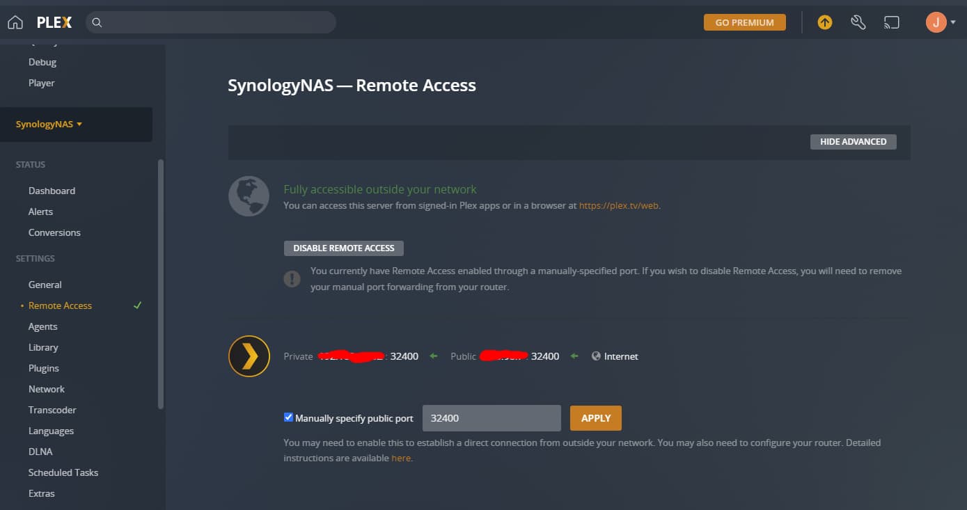

Under remote access I have it manually forwarding 32400 and this matches the port forwarding settings in the router. (Incidentally, Plex will sometimes tell me in that screen that my server is reachable remotely, and sometimes not, but even when it says it’s not reachable remote access works occasionally).

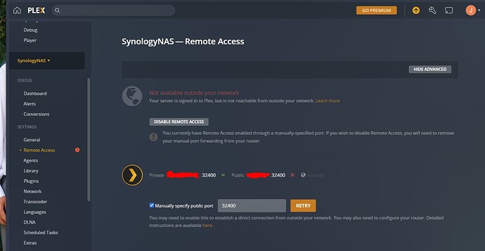

Rather than start a new thread I have a similar yet different situation. I have not changed ISPs or routers since I installed PLEX a year ago. However, my son recently texted me and said that he could not connect to my Movie library. So I went to check the server. When I initially log into the settings the remote access does NOT have a green check mark next to it. When I click on the Remote Access tab, however, it changes to the green check mark for like 2 sec and then says that it is NOT AVAILABLE OUTSIDE YOUR NETWORK. When I hit RETRY the connection goes green and looks like it is working until I select any other setting. I did accidently remove the app from the NAS drive recently while attempting to update the software but then I added it back, everything seemed to be as it was before (meaning I did not have to rescan my library). But I did not check to see if my son could see the library and I did not go into the settings. Everything works fine in my house behind the firewall.

Appreciate the detailed feedback. In my case, I don’t think I have a hardware or bandwidth issue. I have a fiber connection (on both ends). When remote access is inaccessible it’s entirely inaccessible. I’m not having any issues with lag or pixilation when remote access is working. When it’s not working, the server isn’t showing up at all. I have port forwarding set up on my router, though the problem (inconsistent remote access) is persisting through two different routers now. I turned off the relay and that didn’t seem to do anything one way or another. So, I suspect there is a networking problem that is preventing remote access from finding my server reliably, but I can’t for the life of me figure out what it might be.
