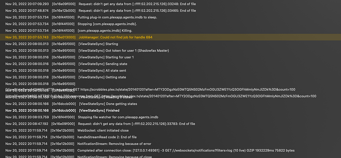

EDIT 2: Managed to capture some Screenshots of the console when the issue happens cause there are no Crash Reports. I see something about a incomplete TLS handshake and connection reset for my WAN IP. Could this cause Plex to abandon network after every half an hour? I remember something similar with certificates, they had to be “reset” somehow in order to connect to my server again., but I don’t know who did it and if that would be the solution… And I’m seeing SSDP Parsing for Nework Devices like my “hue bridge” and “fritz WLAN Repeater”. What are they doing there? I already unplugged them, changes nothing…

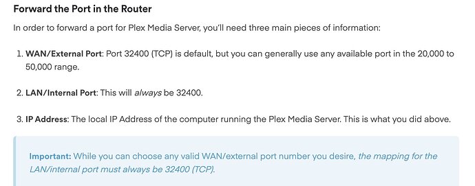

Hi again. please read through this support page and make sure you have NAT-PMP and UPnP disabled. Port forward to 32400
https://support.plex.tv/articles/200289506-remote-access/?utm_source=Plex%20Forums&utm_medium=Sidebar&utm_campaign=Plex%20Forums
Hi again, thanks for replying
everything is setup accordingly, UPnP is off and the Port Forwarding works correctly for around half an hour. Then it disconnects and Server goes in unreachable and unresponsive state. If I try to connect to reactivate Remote Access via http://127.0.0.1:32400 directly on the machine PMS is running on, I get a connection timeout… Only restarting PMS fixes it for another half an hour…

It looks like your screenshot a few posts above zeroed in on what I also saw.
It looks like you have a few things going on beyond a stock install of PMS.
Maybe you have Webhooks running a Phillips Hue.
There’s a also a bunch of scrobble entries and talk of ViewStateSync. So I wonder, do you have this truned on? https://support.plex.tv/articles/sync-watch-state-and-ratings/
I would unplug that Phillips Hue and remove the webhooks, then retest.
if it still fails, turn off sync watch state and retest.
Hopefully someone from Plex will comment if this looks familiar.
