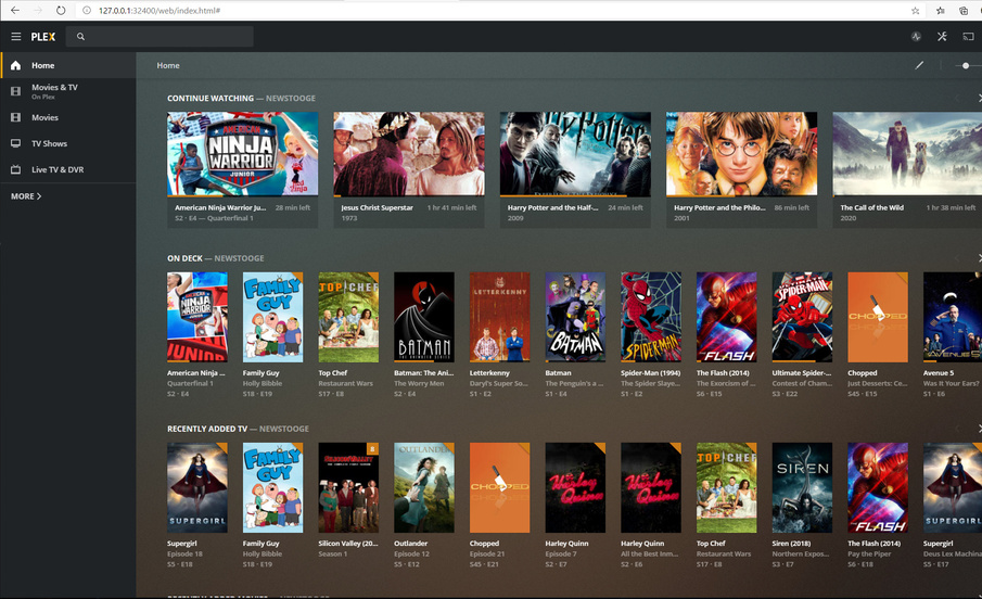

My home screen seems okay I think. I’ve included some screenshots to help clarify. I also tried changing the friendly name from STOOGE to NEWSTOOGE to distinguish them. As you can see STOOGE is not connected and really doesn’t exist I guess. The restored NEWSTOOGE is running but having some issues. There’s no SSL/TLS anymore and it seems like metadata might not be syncing. I’m thinking this all is related to the plex system seeing two servers where there should be one. I probably made it worse by releasing the server and reclaiming it, but I was desperate and I saw it in another post.
By releasing and reclaiming your server, you caused a new cryptographic certificate and DNS entry for your server to get created.
Depending on your ISP, your router (and occasionally other network components) this change may need some time (minutes, hours or even days) to propagate.
You might be able to speed it up by:
  1. set the “DNS server” preference in your router to that of Google (8.8.8.8 and/or 8.8.4.4)
  2. reboot your router
  3. reboot your server
  4. reboot your client(s)/empty your web browser’s cache
In this order.
I’ve rebooted and the extra server is gone. But nothing has changed with regard to the SSL/TLS. I still have to accept insecure connections each time I visit plex.tv. Can I force an update?
Without knowing where the old/invalid certificate is “stuck”, I don’t think so.
You may have to wait until the certificate is expired (~1 month or something like that).
