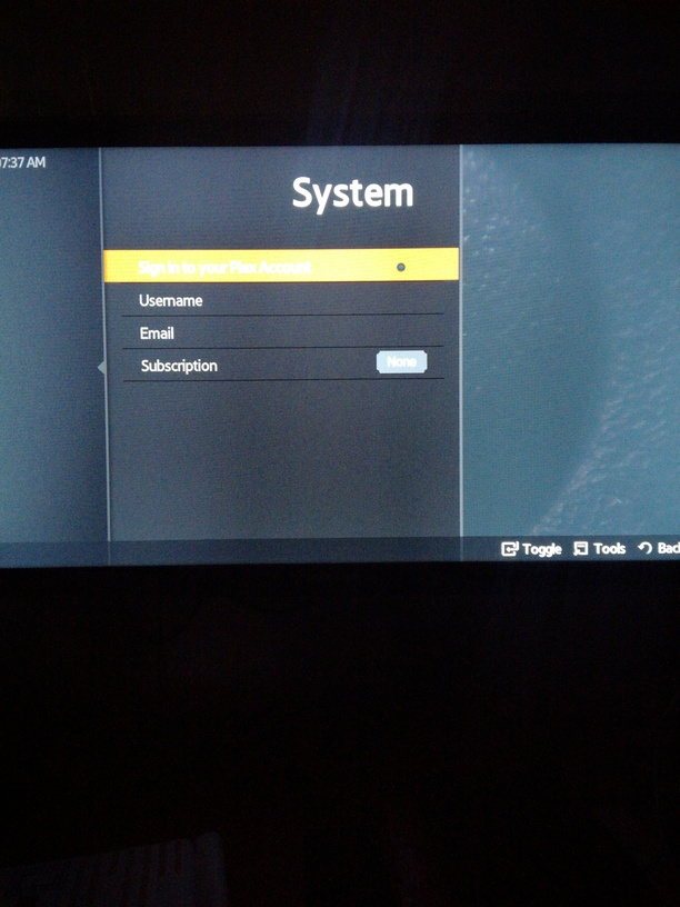

I have a western digital my cloud home as server and a samsung tv model U40D5500.
I have installnstalled the app from samsung app store but when I launch it, it and press here:
It jumps by itself here:
I can’t fill my login informations on that screen
Please help me, that app used to work but after an hard reset of my TV and a reinstallation of the app I am locked here :(:lying_face:

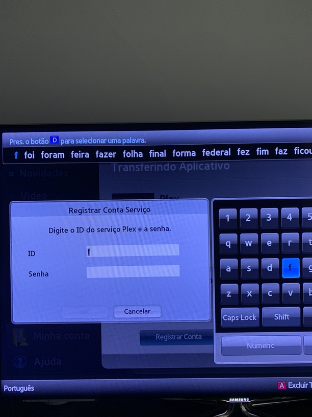

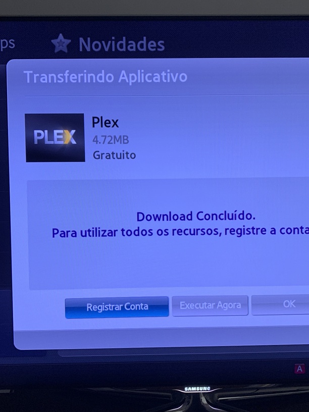

Hi I have the same issue. But I found when you install the app now you have the option to “Register Account”
But I tried to put my login or my e-mail in the “Service ID” but I get a mensage saying ID not found
Estou com o mesmo problema.
Tentei “registrar conta” ele diz que não é possível registrar e o problema continua.
Alguma solução para o problema?
I have the same problem.
I tried to “register account” it says that it is not possible to register and the problem continues.
Any solution to the problem?
