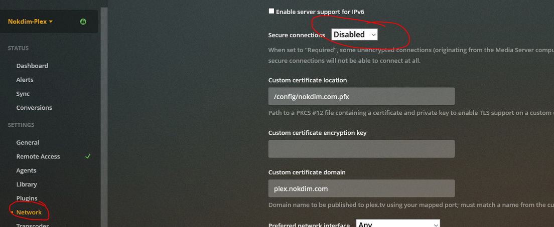

Have you tried to set secure connections to disabled?
