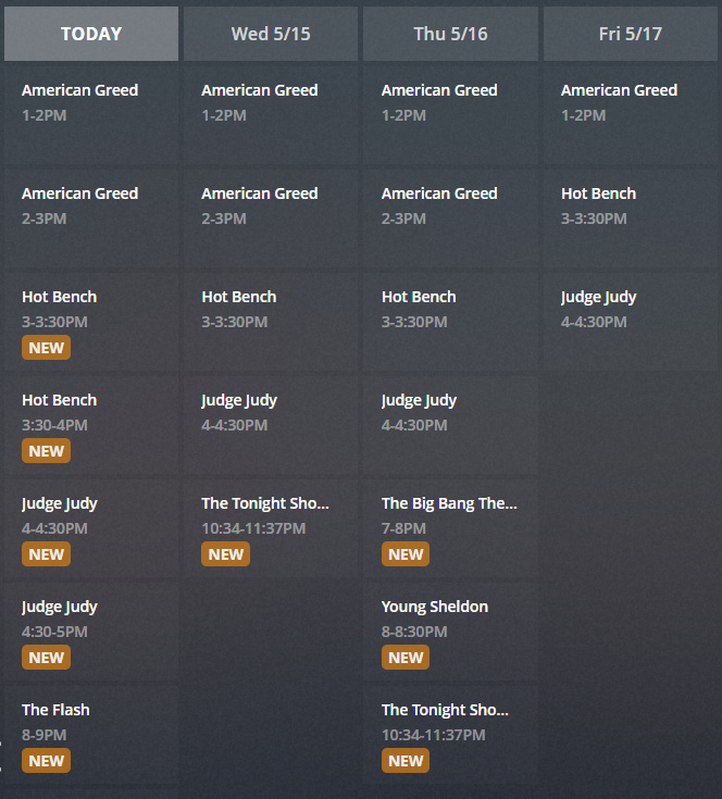

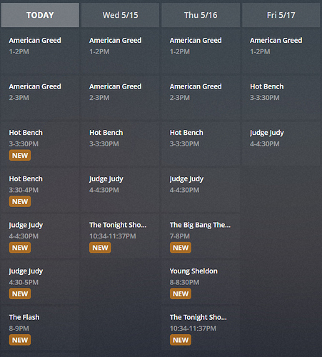

Tell me if this sounds right… You could possibly screenshot your entire week of recordings, and for the most part, everything appears as it should.
You go back in the day you expect to see recordings, or perhaps look back over the past few days and discover items have completely disappeared, with no indication whether they recorded or not.
The old issue, which seems to have returned, is that when the guide refreshes for the day items are dropping off schedule. I don’t remember what they did to fix it in the past, but I’m pretty sure there’s nothing we can set on our end to fix it. It went on long enough for me to screenshot the week in advance, and show the missing items later.
For me, I had previously been dropping CBS shows fairly often, but not all of them. It appears I dropped The Big Bang Theory last week as well.
EDIT: If my rusty memory serves, it might have something to do with back to back recordings on the same channel? Does that fit your scenario? Young Sheldon recorded fine for me (2nd show in the series of back to back)
I took some shots to show last week vs. this week for me, and I’m already discovering things that have dropped. Hot Bench and Judge Judy air back to back programs.
Last week: (No Judge Judy, Hot Bench, or Big Bang)
This week: (Already missing second airings of Hot Bench and Judge Judy on some days)
I’ll update after Thursday or Friday to see if anything else disappeared from this week.
