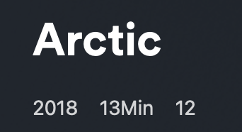

So, a recording last night again didn’t run as scheduled.
The DVR job for the “Arctic” was scheduled to run from 3:30 to 5:00.
However, the final recording only lasted for 13 minutes:
The log shows that the recording stopped at 03:42:

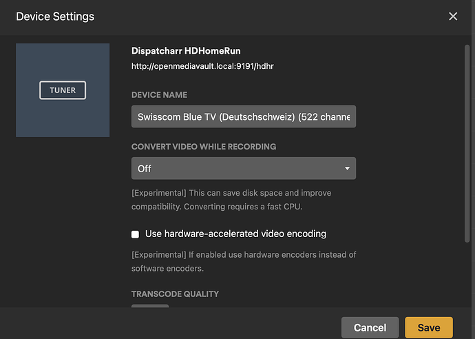

Can you share your DVR device settings? Go to your Settings -> [Select Server] -> Live TV & DVR and select the cog next to your guide source:
It should look something like this:
These problems are almost always a problem with the stream stability from the tuner; for real tuners this is usually the result of poor signal quality. For IPTV sources it’s usually a result of unstable streams.
Given that you’re using a virtual tuner, there may be some configure you can do on that side to configure a buffer to stabilize the stream. xTeVe and Threadfin, for example, support configuring buffering.
I’ve tested the streams by letting the live tv run for a couple of hours and never had any issues with streams stopping or buffering, though.
