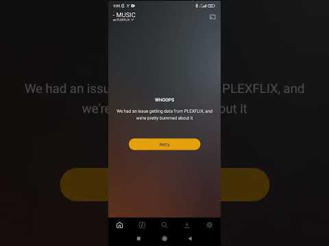

Most of the time I use Search I end up with a wheel of death.
Sometimes it works, for a few searches I have the results in a second, then, the Search is crashing.
I can have this issue with every of my devices, database optimised, with a strong Internet connection 4G or WiFi, it doesn’t matter.
Specially if I am looking for a search with more than 2 words, but even with 1 word it can happen.
It is so frustrating. Most of the time to stop it I have to force close or/and delete the cache.
This issue is there since a long time. If I try to do the same searches on Qobuz, Tidal, Spotify, Appel Music, I have instant results. With Plexamp, it doesn’t work, Search is weak in my experience.
I recorded a video here, this is just one exemple, I can reproduce this issue in a minute using this fonction.

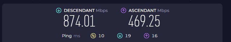

I tested my connection before the test :
My PC :
My phone :
to be sure i have a good connection.

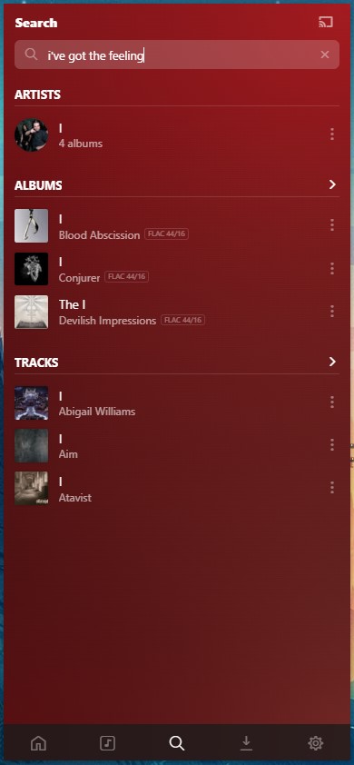

I made a search for 2 bands :“The Beatles”, “Beatles”, “The Who”, “Who”, and 2 songs :“i’ve got the feeling”, “A little cold” that i have in my librairie.
Plex app localy found everything.
Plexamp localy found the bands, but make mistake for "i’vegot the feeling:
it’s stay there and nothing came after
as for “a litlle cold” it didn’t find it and made a wheel of death after i changed the search for “little cold”:
Plexamp on the phone had similar results from plexamp on pc for the bands but i couldn’t try the songs because of a wheel of death
