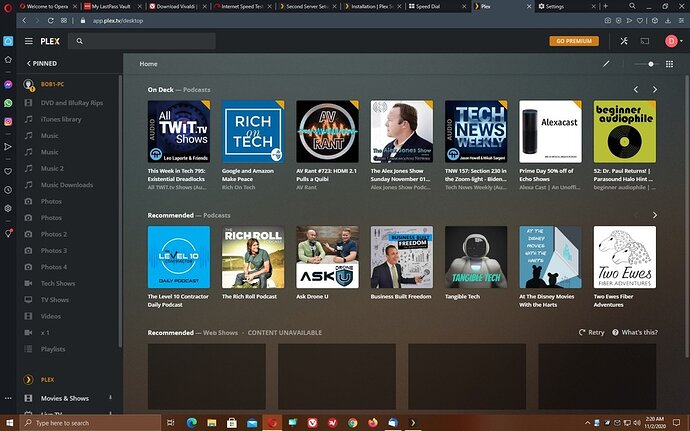

I still cannot set up a second server as I did before. Here is what I have:
. I would like to add a second server on this PC other than Bob-PC which is on my other computer. It must be something easy but it eludes me. Please help. Thanks.

In your screenshot you have opened Plex using http://app.plex.tv/desktop.
That version of Plex Web is running independent from your actual (physical) server. As described above it has therefore no idea the 2nd / new server also belongs to you and cannot show its libraries.

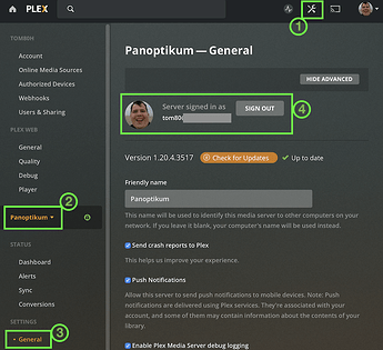

  4. Go to Settings [#1] > [new server name] [#2] > General [#3] to confirm the server is signed into your account. If it is, the box #4 in the screenshot below should show your account name – if it’s not yet signed, you’ll see a button to “claim” the server instead (in place of the sign-out button)

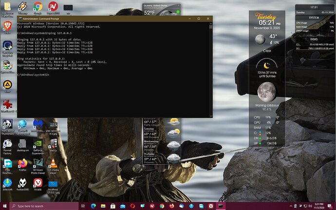

The Plex web app is running but the 127.0.0.1:xxxxxx url is unreachable.I removed the Internet information server from add/remove features and pinged 127.0.0.1…See enclosed cmd:
What do you mean? If you can’t access the URL, then it’s not running. Also, my question was about Plex Media Server.
That is what is confusing. 127.0.0.1 can be pinged successfully but http://127.0.0.1:32400/web gets me nowhere. The plex app is running on this computer but not my server on this computer. Should I run Plex on the living room Computer which works normally? Thanks for your patience in this matter.
