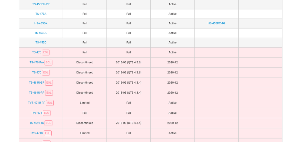

I was unable to open Plex Media Server. I searched and found that the QNAP version 1.16.6 (last working version) are not being supported any more.

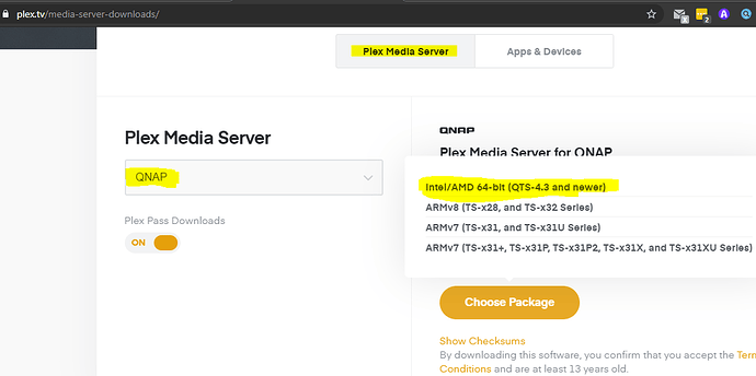

So I went to plex downloads and downloaded the intel/AMD 64bit version of Plex Media Server
I downloaded ver.1.22.0.4163 (QPKG file) and installed it manually to the QNAP.

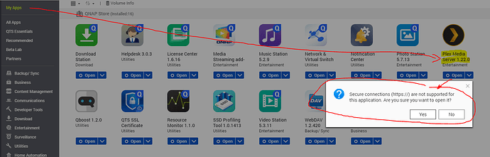

I noticed that the QNAP version (1.16.6) also shows as installed, even after I removed it completely. But if I click to open ver.1.22.0.4163 I get the following information message: “Secure connections (https://) are not supported for this application. Are you sure you want to open it?”
If I select No, nothing happens. If I select Yes a new tab opens to this address: “http://192.168.101.197:32400/web” with the following message: " Not Found - The requested URL was not found on this server.", including a “Not Secure” site information indicator in Chrome browser.

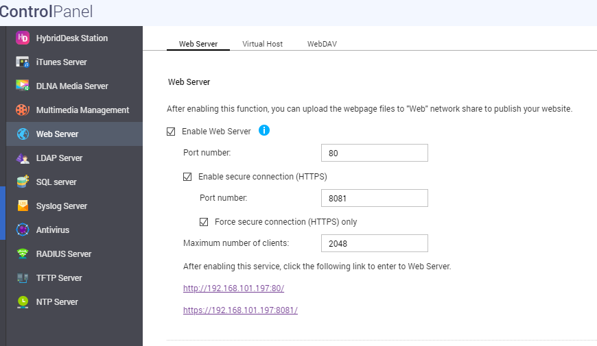

I checked that the Web Server is enabled, Secure Connection is enabled, and ever enabled Force secure connection only. After enabling force I try open (https://192.168.101.197/cgi-bin/) but still nada/nothing.

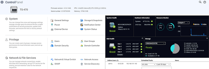

I think the OP has a TS-470 which has a Celeron G550 - a 64-bit CPU.
