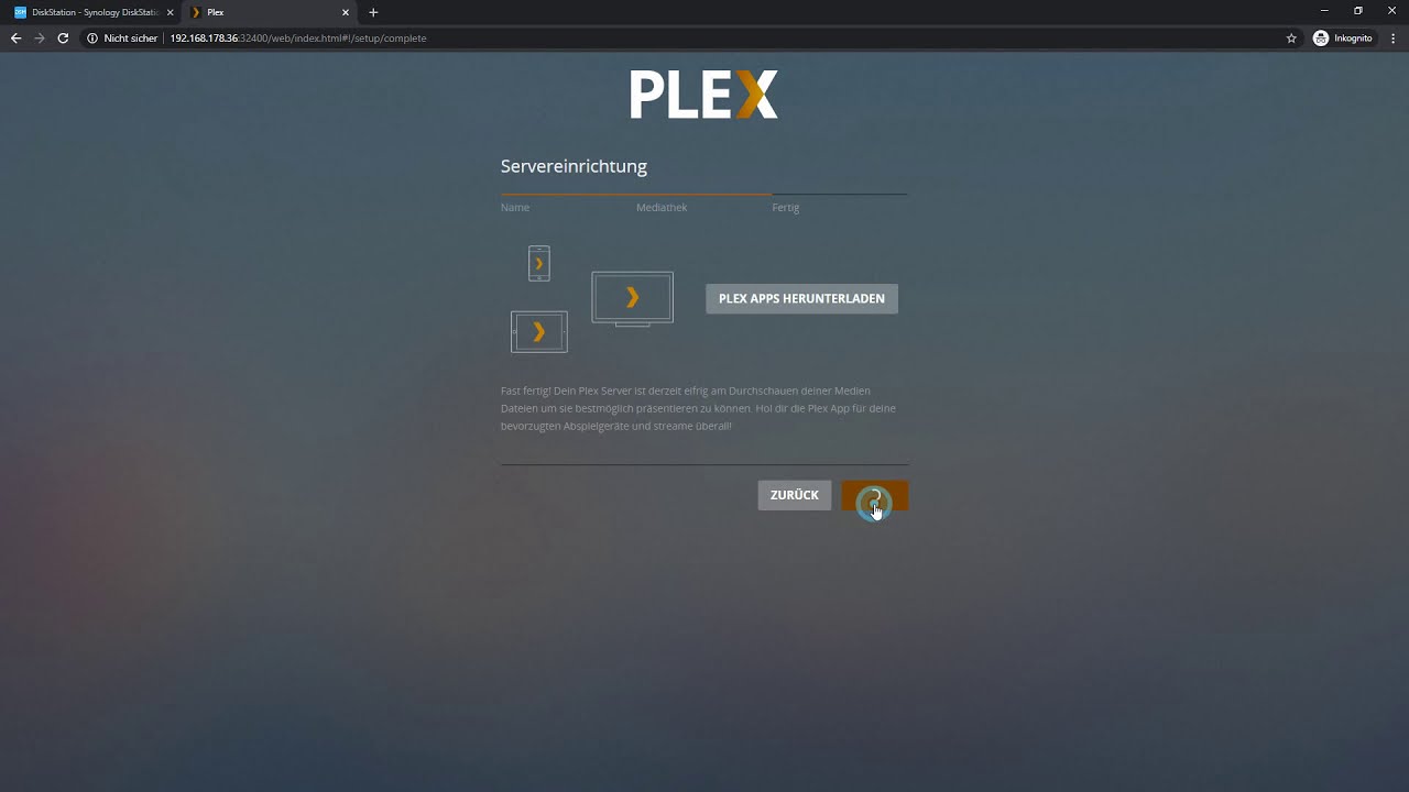

I do not really understand what you mean. It took some time (I hate cutting videos ^^), but now you can see it in this video:
Thank you for taking the time to create the video.
I understand no; It’s a regression in PMS itself.
