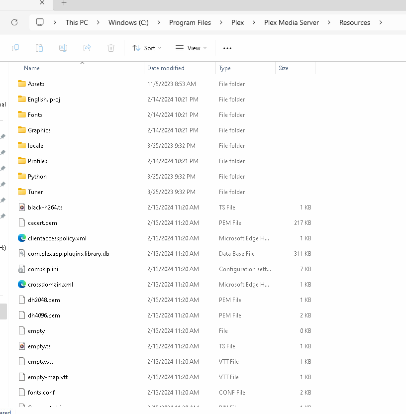

I’m not referring to the Plex data folder path. That’s completely separate. I’m asking about the Plex Media Server installation path that you chose during installation. It’s the path where your “Plex Media Server.exe” executable lives; the .\Resources\Plug-ins-*" folder should be in that same path.
(The registry setting you mentioned does not change the server installation path, only that of the Plex data path.)
Plex Media Server installation folder:
vs. Plex data folder:
@pshanew To avoid any confusion, below are my folders:
And finally the Resources folder:
Thank you,
Perfect, thanks! This confirms that the required Plug-ins folder is missing from the Resources folder in the media server’s installation path. (It should be right between ‘locale’ and ‘Profiles’ in your final screenshot.)
In fact, based on your first screenshot, it’s one directory level higher than it should be (sitting beside Resources instead of inside it). Try moving Plug-ins-c29d4c0c8 inside Resources and restart PMS. The final path to it should end up being what I posted above. Again, for reference:
C:\Program Files\Plex\Plex Media Server\Resources\Plug-ins-c29d4c0c8
@pshnew Yes, you’re perfectly right, now everything seems to be back to normal, including the capacity of editing the libraries, thank you!
Still, definitely there is a bug in the installation executable of this version, and I think that the misplacing of that folder is somehow connected to my specific configuration of that registry value.
