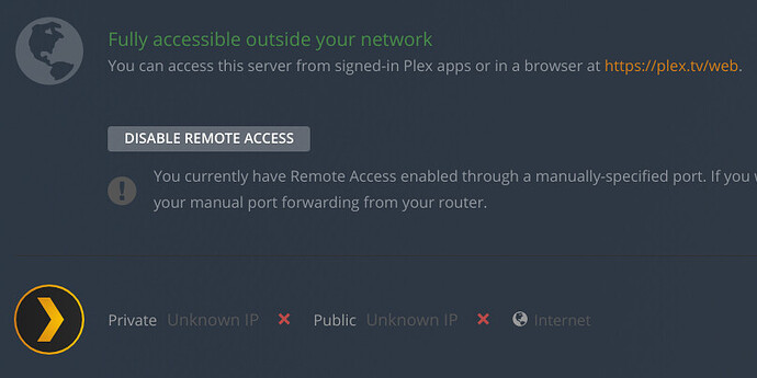

I’m having a weird issue with remote access that has occurred twice in the past week, and a couple more times a longer while ago. The server is not accessible outside the network, even if the dashboard says it is. Restarting the server will make the dashboard update and show Unknown for both the private and public IPs. Port is forwarded in the router, I’m not behind double NAT, and everything has been working fine for years until recently.

So I’ve been having this problem for the past 24 hours, rebooted the server and it didn’t work. Rebooted the router just now and the server is once again accessible remotely. Last time this happened a router reboot didn’t immediately work, and the problem “fixed itself” a day later. I don’t know what’s happening, I’m glad it’s fixed now, but would be nice if I can get to the bottom of this…
Happened again, finally called the ISP, they reconfigured their equipment, I restarted my router, problem solved.
