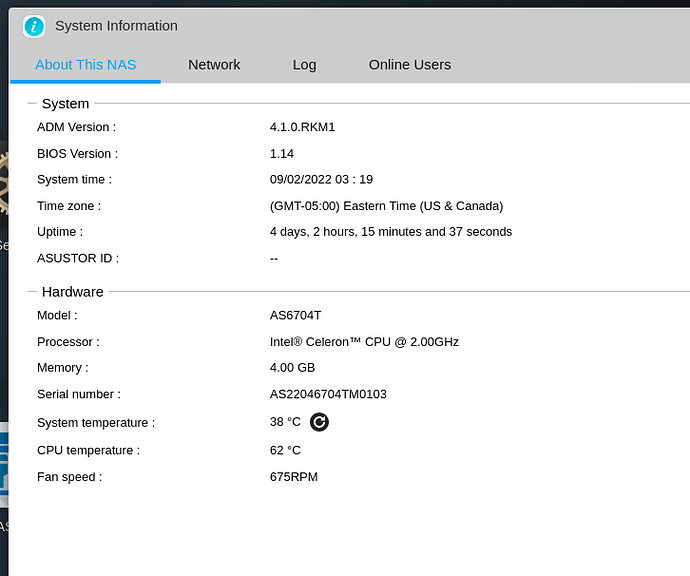

@jbo44112
The -p option is for specifying the Plex Preferences.xml location, not the $PATH variable :slight_smile:
I wrote this using the sample machine provided to us.
[chuck@lizum ~.1422]$ ssh -l root as6102
Password:
root@ASUSTOR-AS6102T:/volume1/.@root # curl
curl: try 'curl --help' or 'curl --manual' for more information
root@ASUSTOR-AS6102T:/volume1/.@root # which curl
/usr/builtin/bin/curl
EDIT: I did find a non-related issue for ASUSTOR which only impacts that machine.
Bug is fixed. Released.
Issue is resolved: Version tag is v1.0.3
