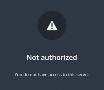

Changed admin password and now admin doesn't have access to the local media server
Server Version#: Version 4.76.1
Player Version#: N/A
As the title explains, I changed the password of my admin account and now I don’t have permission to access the local plex server hosted on my NAS (via a docker container). All I see is the below image. Does anyone know how on earth I give the admin account access again?
I’ve already tried editing the preferences.xml file and removing the following:
I then duplicated the docker container, pulled the latest image, and tried logging in again. Still don’t have access to the local server.
I am also accessing the server via the local ip:32400 port.
Same situation here after I changed the admin pass according with the email with security breach received.
The difference from vividus101 is that I run the server directly from a Synology NAS, not via container. Error is the same
in preference.xml the token appears as null
PlexOnlineToken=“”
Same here. Updated my password, tried to access my library and I get the very same error. Running plexmediaserver on Linux VM. Can’t access locally nor via any app or web interface anymore.
I am also having this same issue. I’ve reset my password. The process threw an strange token error but seems to have worked, as I can log in with the new password.
  • I have done the above steps removing the entries from Preference.xml.
  • Logged in, logged out.
  • Remove all devices from my account.
I even have taken the step of uninstalling plexmediaserver, sudo apt remove plexmediaserver, removing the entire /var/lib/plexmediaserver/Library/Application Support/Plex Media Server directory and re-installing plexmediaserver.
Nothing. The server will not show up in my account. :person_shrugging:
Edit: I am NOT running this on a Synology NAS device, however. I am running this in an LXC container on Proxmox. I don’t believe this is an issue with the device, but rather the Plex accounts themselves.
