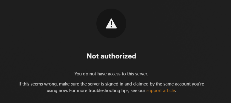

I installed the server. I can see the server icon in the taskbar.
If I open the desktop app I get this:
But going to ‘your media’ shows this:
How can I configure the server? Where can I tell it what directory my media is located. How can I get the app connected to the server. It looks like they are not seeing each other.
Did you previously have a Plex Media Server installed on that server (possibly using a different Plex account)?
Do you get the same result if you open http://127.0.0.1:32400/web on the machine running your PMS?
Yes. That is possible. Although that was years ago. I did an uninstall hoping that would solve it. But maybe an uninstall leaves stuff in the registry? And yes, I see the same from the web interface.
So I searched the registry and found indeed another username. No idea what the pwd was, I reset it. So in the plex app I signed in with that username. No problem. But now I dont see ‘My Library’. I do see 'Ben’s Computer" , but when I select that:

The above images I see when I am at this URL: https://app.plex.tv/
And I can see that the account used there is the username of the server.
I see the same thing happening from the app. However if I connect to http://127.0.0.1:32400/ I do have access to My Library.
