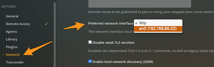

when on that tab and to you go into server settings under Network does it have anything in this dropdown or does it only have the option of “Any”

This is what it says there:
Snapshot_2021-03-20_174001_127.0.0.1
that’s my server’s local IP
Did you change the second octet of your DHCP server on your router to be 170? that is your problem it is a non standard local IP. it should be 168
192.170.0.25 is is owned by Hewlett Packard probably for one of their corporate headquaters 192.170.0.0 - 192.170.0.255 - USA | Myip.ms
I did change it a long time ago, and I could change it back, but this has never been an issue before when I was using my old laptop as a media server for the past 3 years or so. Not sure why it would suddenly cause a problem on this new laptop…
I can’t say what happened on your old computer. But when you sign into or claimed your new server it makes pings to that address and it is pinging and probably getting bad or not authorized responses from HPs headquarters. so it is not sending responses correctly to you. and when you claimed it the security that kicks in gets confused.
if you are trying to have security by way of obscurity, change the third octet 192.168.X.25which can be anything from 0-255 like 192.168.30.25
